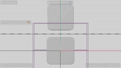

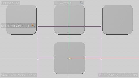

<p dir="auto">I have a question to ask around cloners. I'm trying to create an animation with tiles using a cloner where one tile rises from another and in turn branches off in to 3 clones and then another 3 clones to create a kind of tile tree. See attached intermittent frames taken at  0, 30 and 60. I'm wondering if there's a way to achieve this with just one cloner please?</p>
<p dir="auto">In my current setup I have one cloner that clones the original tile and a second cloner with a display tag to animate visibility so that it appears after the original tile animation.</p>
<p dir="auto">Thanks very much in advance for your guidance.</p>
<p dir="auto"><img src="/assets/uploads/files/1752153682726-animationexample0060.jpg" alt="AnimationExample0060.jpg" class=" img-responsive img-markdown" /> <img src="/assets/uploads/files/1752153682686-animationexample0030.jpg" alt="AnimationExample0030.jpg" class=" img-responsive img-markdown" /> <img src="/assets/uploads/files/1752153682663-animationexample0000.jpg" alt="AnimationExample0000.jpg" class=" img-responsive img-markdown" /></p>

<p dir="auto">How about creating 27x4 clones, hiding all those that don't create the "tree," and then progressively showing the layers?<br />
Example<br />
<a href="/assets/uploads/files/1752173605092-cv4_2025_drs_25_mgbt_01.c4d">CV4_2025_drs_25_MGbt_01.c4d</a><br />
Which avoids to sort the distance  with the growing tree.</p>
<p dir="auto">Alternative (MoSpline&gt; Turtle)<br />
Turtle might help here; the link holds as well a MoGraph adoption, so specific "endpoints" can receive predefined Clones.<br />
https://help.maxon.net/c4d/2025/en-us/Default.htm#html/OMOSPLINE-MGMOSPLINEOBJECT_TURTLE_GROUP_TURTLE.html#MGMOSPLINEOBJECT_TURTLE_MODIFIER</p>
<p dir="auto">Since this is a Growth Model, to have just levels showing up, the Growth Slider animation needs to be a Step for the keyframes.<br />
https://cineversity.maxon.net/en/series/mospline_tournament_bracket?tutorial=tournament_bracket_part_1</p>
