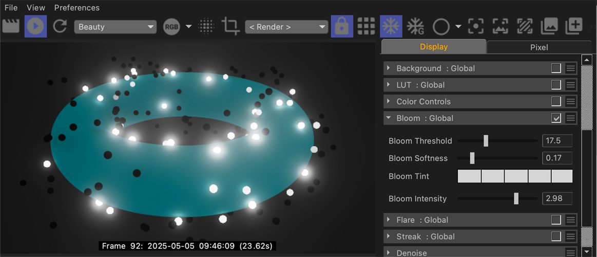

              Hi sign-mission,
              Please have a look here
              CV4_2025_drs_25_PAbc_01.c4d
              The spheres use the Age of the Particle in the Color mapper, which is then used in the Material. The Material has a User Data node to take the information from the Cloner
              To enhance the effect, you can use the Bloom option.
