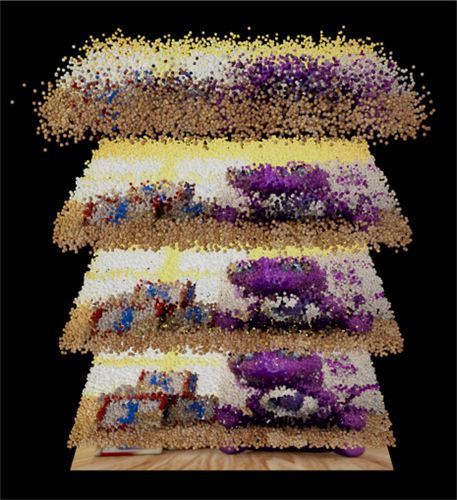

                          Anyway, there is a different way, and I use it with a Standard material (to set it up go for a moment into the Standard Render Mode, call up a material, and place the image in a channel. Please compare the file below.
                          Then go back to Redshift. This color channel can be used inside the Vertex Color Tag/map, which means the mesh needs a very good density to produce enough "points."
                          This map is needed inside the Surface Emitter in the Properties, Color Map>Vertex map.
                          Then, use a Surface Emitter and receive color for the particles. I have used an RS Render Tag here.
                          CV4_2025_drs_25_RScp_01.c4d
                          Please let me know if that works for you.

                            gate-lady last edited by
                            Heard and heard. It works just as I need. Thank you for such a clean fix!
