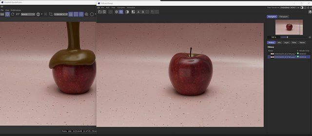

      OpenPBR material applied to xpOpenVDBMesher renders fine in Redshift IPR, does not show up at all in Picture Viewer render.

          Solved: it was because there was a Cache tag on the Mesher. (I don't remember putting it on there, but obviously I did.) I deleted the cache tag and all became well. Thank you for your input!
