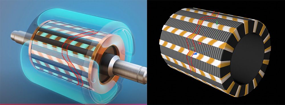

      The Youtube video shows a rotor on which magnetic lines (OPrange) swing back and forth.
      In my attempts with an animated texture, I cannot create this effect.
      It looks simple but it is difficult.
      https://youtu.be/GveMZDKAQ-A?t=230
      magnetlinien_beispiel_1.c4d
      I would be very grateful if you could help me.
      Thank you very much

        The cylindrical projection is set into UV data.
        Object Manager> Tags> UVW> Generate UV Coordinates.
        I have reset the Materials Coordinates.
        The animation is purely based on the Material Tag> Attribute Manager> Tag> Offset U (Interpolation of the Keyframe is set to Linear.
        Higher value, faster animation.
        The "Coil" is rotating as well, you might adjust that speed.
        The "Klon" had its axis not centered, so I snapped it to the center. 9Axis tool and Snapping to Point)
        CV4_2025_drs_25_RSmt_01.c4d
        My best wishes for the project

          On the left in the picture, the original has a completely different waveform to the one on the right in our example.
          I can't adjust this with the shader.
          Thank you very much
            Hi selection-it,
            Yes, the closest I was able to get this with your shader setup (Tile) is this. The amount of Waves decreases when the "Amplitude" is higher. So you could double and offset the Tile, but that works only with UV Information, which limits the ease of animation.
            If you want to match this, create a texture. You have the Amplitude defined, the amount of waves, and based on your drawing, it is roughly a 2HZ frequency. If you like an example, I can create one.
            Here is an example
            https://projectfiles.maxon.net/Cineversity_Forum_Support/2025_PROJECTS_DRS/20250410_CV4_2025_drs_25_RSmt_11.zip
              P.S. Here is a file that allows you to render the needed texture in pretty much any resolution.
              CV4_2025_drs_25_TXhz_21.c4d
              Open that texture then in the Material> Texture of the file below
              CV4_2025_drs_25_RSmt_21.c4d
              The key to getting an even line as a wave is to look at the vertical width of the wave line, which the Tile can't offer.
                selection-it last edited by
                Hello Dr. Sassi
                Thank you very much for your help.
                It works well for me.
                Have a nice weekend.
