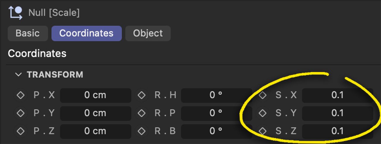

            The size can be changed. Just place all parts under a Null, then use the Coordinates of that Parent Null and set the scale.
            Example
            CV4_2025_drs_25_ANbs_02.c4d

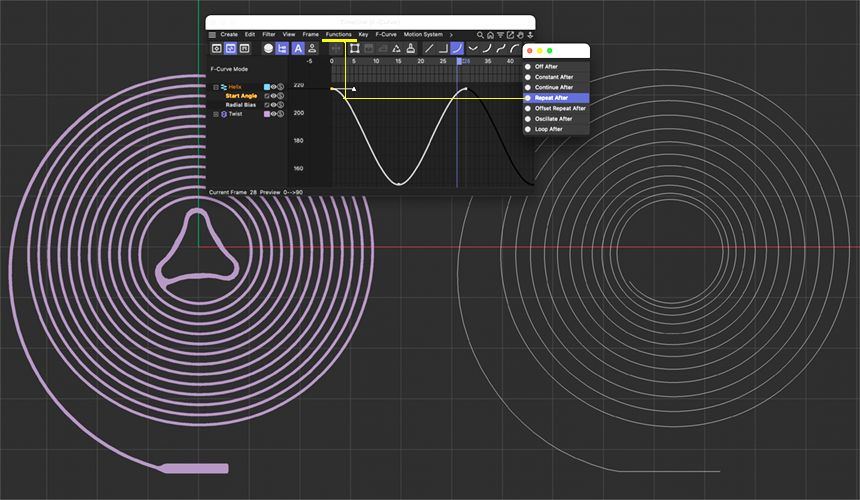

                The CAD part was mostly needed for the size, however, I used a simple and hopefully useful method to get it animated. The key to getting such a complex animate shape to move in the needed way is based on the falloff of the Sphere Field. This might be the way to go if the little imperfections are not in the way.
                CV4_2025_drs_25_ANbs_11.c4d
                Besides, I have included a Spline animated version, this time just with Keyframes and the Timeline Editor> Function> Track After> Repeat After
                To get this working the first key of a F-Curve needs to be selected (Active)
                I combined three Spline into one since the provided shape is not doable with the Helix alone.
