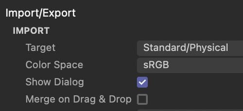

      Please help me, im getting crazy, i never had any problems with importing mixamo characters into cinema 4d, but now with that node trash editor system my character and hairs are all complete black?? is there any fix on how to do this??? Cinema 4d 2025 / redshift
        Hi charity-chance,
        I would suggest using the Preferences: Import and switching to Standard Physical, while leaving terms like trash out of this forum. OK!? Thank you.
        https://help.maxon.net/c4d/2025/en-us/Default.htm#html/PREFSIMEXPORT-PREF_IMEXPORT_MAIN_GROUP.html#PREF_IMEXPORT_NODESPACE
        Preferences> Import> Target
        I tested this with a current Mixamo FBX, and it works just fine.
        Take care.
