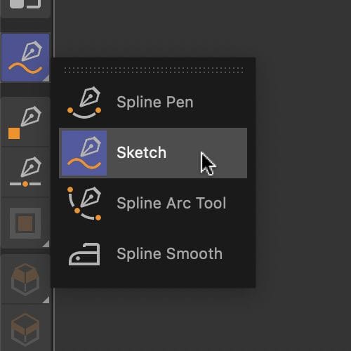

        Get the Sketch Pen (left side bar menu). If the created Spline is active, it will be added to this. Click in the Object Manager to deactivate, and it will start a new object.

        Start drawing. If you are in the Perspective Editor View, it takes the World origin and places a "virtual plane" there. Changing the view changes the virtual Plane.
        In front, right, top, etc, view it takes that view and draws flat on the world origin (the X, Y, Z = 0, 0, 0 point)
        If you need the plane elsewhere, use it and switch on Snapping > Polygons. Start drawing. The Plane is needed only during sketching; deactivate it or delete it as needed.
