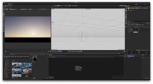

      Good morning everyone!
      I’m trying to use RS Clouds, but the clouds are not showing up in the IPR. What am I doing wrong?
      Thank you!
      Leandro!

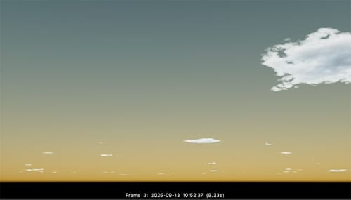

        Hi spot-target,
        Here is a 2026.0 file. I use the RS Render View and move the time slider.
        CV4_2026_drs_25_RScl_01.c4d
