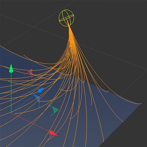

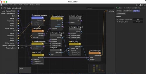

      Trying to recreate in Scene Nodes Mograph setup for soft connections between objects. Struggling with controlling tangents, for some reasons spline becomes closed and it causes artifacts. Also spline not affecting to Null(Start) rotation, only position. Spline tangents in Scene Nodes 01.c4d

        The Tangents are not happy with the Matrix information. I used the V1 of the Matrix here, assuming the Null will not be scaled. (V2 or V3 would work as well, but starting in a different direction) This V1 has all the information for one Tangent. More about this here:

        The Spline wasn't closed. Please check the "Assemble Spline Node"; the checkbox is not set.

          P.S.: I have explored your file a little bit more:
          Perhaps that allows you to create what you like to have.
          CV4_2026_drs_25_SNrt_21.c4d
          You can move and rotate the Null [Start] as well as the Landscape.
          In the Inputs, I have set the Tangent Length.
          Enjoy.
