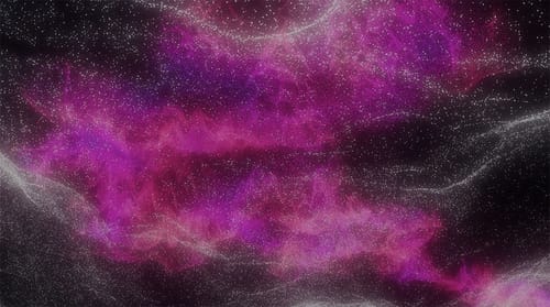

      I'm trying to create a particle system like the one in the image, but I can't quite get the look right. I'm trying to do it with Matrix and Shade Effector, with different levels, but I can't seem to get it right. Does anyone know how to do it correctly?
      The animation is from this video https://youtu.be/9TLNDJH9E98?si=ShN-pHyhsoPpn766 minute 1:12.
      Thanks for a lot

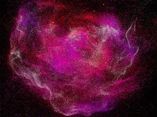

        Frame zero and one frame forward, all is done, render.
        The setup uses a Plane and a Displacer. (A Landscape object might work as well)
        The "Math" object changes the radius of the new particles, simulating different distances.
        In the Surface Emitter, you will find a Density Distribution, just to get closer to the chaos the Universe provides.
        I hope that is a supportive starting point. Tip: Explore a second setup larger and in distance, with smaller particles.
        Enjoy your project

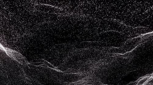

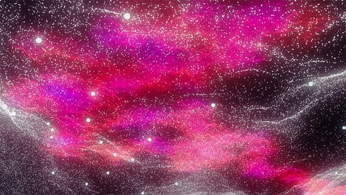

          P.S.: Here are two files to explore, which may lead to the next steps. Just a few ideas wildly combined. Switch on and off anything that places forces or direction into the scene (I have marked the five influences with a color chip)
          Static
          CV4_2025_drs-25_PAsf_02.c4d
          Animated
          https://projectfiles.maxon.net/Cineversity_Forum_Support/2025_PROJECTS_DRS/20251006_CV4_2025_drs-25_PAsf_03.c4d.zip
