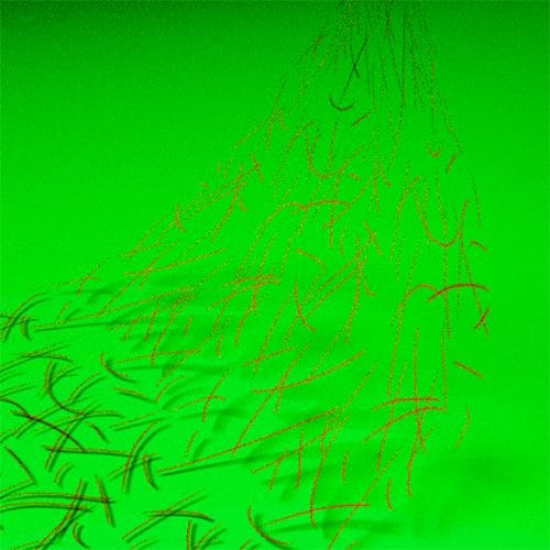

        Please explore the two files below.
        One is based on a simple simulation, the other uses just deformers to create the effect.
        These are just rough starting points.
        The key here is first to find something you feel most comfortable with to change during a project.
        The version with the texture and deformers might benefit from a second layer of "hair" while moving it a little bit differently, to give it a more natural move.
        Texture and Deformer-based
        https://projectfiles.maxon.net/Cineversity_Forum_Support/2025_PROJECTS_DRS/20251007_CV4_2026_drs_25_ANhv_01.zip
        Simulation sketch
        CV4_2026_drs_25_SIhw_01.c4d
        just one more detail
        CV4_2026_drs_25_SIhw_02.c4d
        Let me know what feels better to you.

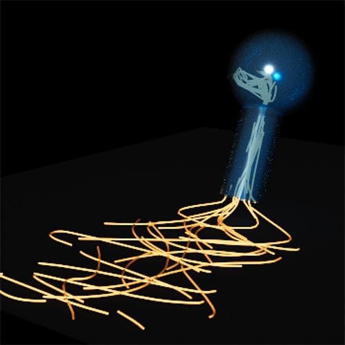

          P.S.: here is a very procedural version.
          The "hair" is just sketched on the Plane, with the Spline Sketch, while Snapping is set to Polygon only.
          It has some set up work, but is super fast.
          The scaling of the "hair" is based on the rail-spline set up, closer to the spline inside the vacuum.
          CV4_2026_drs_25_ANhs_01.c4d
          The silly vacuum-cleaner-model is without any function, just to demo the scene.
          Enjoy
