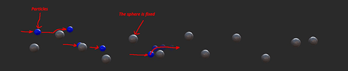

      I’m working with the particle system for the first time and I’ve run into a problem.
      The (blue) particles should not penetrate the gray rigid spheres upon impact. They should glide along the surface of the rigid spheres and then continue flying.
      Do you have a solution for this?
      Thank you for your efforts.

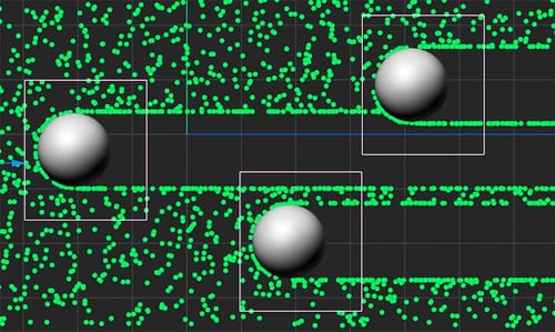

        Hi selection-it,
        Here is a simple setup. Would that work for the "aerodynamic effect"?
        Example:
        CV4_2026_drs_25_PAad_01.c4d
          P.S.: perhaps that is more along your target.
          Example file
          CV4_2026_drs_25_PAbp_01.c4d
          The idea is simple set the velocity in a way that they "fly" along the Z axis, for example.

            Hello Dr. Sassi,
            Thank you very much for your support and commitment here in the forum.
            Your scene helped me a lot.
            Have a nice day and a nice weekend.

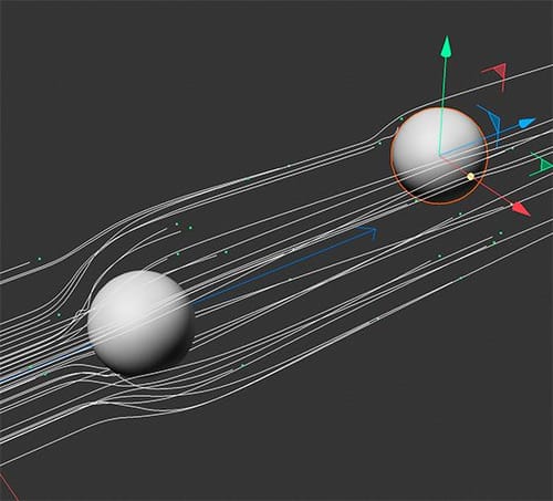

              You're very welcome, selection-it.
              Thanks for the kind feedback.
              (BTW., I explored the Attract option in Flow mode, but to keep the flow along the Sphere, while keeping the following "parallel" (even with a half sphere, seems not easy, if at all.)
              Enjoy your project
                P.S.: Here is a different idea, just with Splines
                CV4_2026_drs_25_PApt_21.c4d

                  Wow, it's hard to come up with an idea like that. I'll test both versions.
                  Thanks for the support, it's very helpful.
