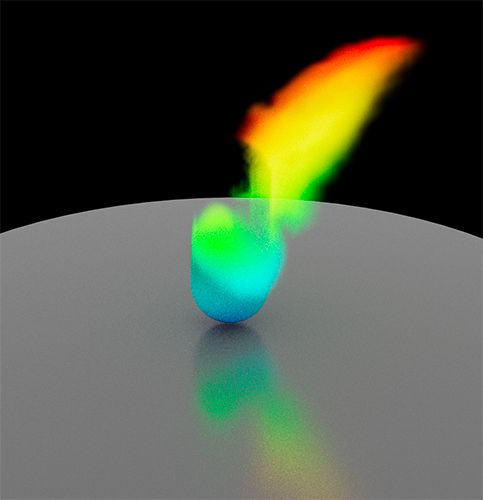

        Sorry, I saw your file too late was in 2025.3.3
        Mine below is in 2026.0. (Edit I got an alert when saving./edit)
        CV4_2026_drs_25_PYsm_01.c4d
        I have attached a transcript if you would like to go step by step.

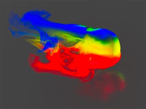

          Hi nopopoch,
          Here is the 2025.3.3 version
          CV4_2025_drs_25_PYsm_01.c4d
          … and your version in 2025.3.3.
          CV4_2025_drs_25_PYsm_11.c4d
