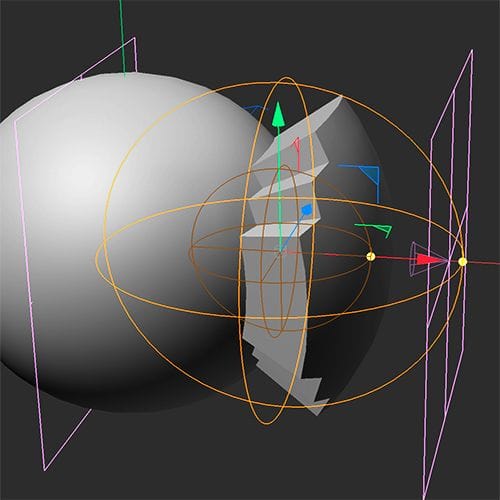

          How about using the "Capsule" Scene Node Deformer from the Asset Browser?
          I have used a Linear field to define the Selection (any fixed/stored selection works as well), and the Spherical field to operate the Field Driver value to set the Extrude Value. (It can, of course, work without the Field Driver; this is a suggestion). The Use Island check box is on.

          Is this working for you?

            Thank you for the example.
            I am looking for something similar to the Maxon training tip video above, where the field/vertex map influences the amount of extrusion for individual polygons. Eg, a noise field would extrude some of the selected polygons higher than others. Your example extrudes all selected polygons evenly depending on the distance of the field to the centre of the mesh.
