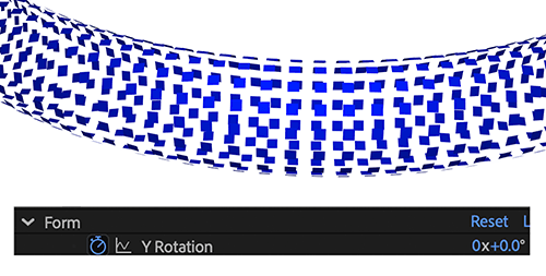

      In Trapcode Form I'm having an issue with getting 'Textured Polygon' particles to orient properly around a Torus 3D model ( both obj and c4d base models have same issue). The textured polygon is just a square inside a precomposition. I want to rotate the 3d model around its centre around the Y axis rotation so it looks like a spinning donut. When Y axis rotation is set to 0 the particles seem to be oriented properly to the 3d model (not 100% properly properly aligned though but closer), but as soon as I rotate the base form (or even world transform rotation) the particles also begin to rotate in weird ways.
      At 0 degrees Y rotation (same for both base form or world rotation)
      (Close to being correctly oriented around the torus but still not 100% correct):

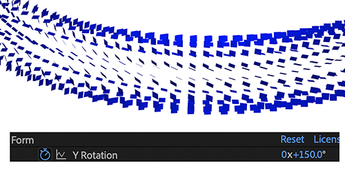

      By the time it reaches degrees 150 degrees rotation (same for both base form or world rotation)
      By this time the particles have completely started rotating weirdly not what I want:
      It's tricky to tell but the particles themselves seem to be rotating individually in their y axis which is not what I want to achieve..... I have baked the torus and aligned the normals. This happens when both when the 3d object is 'Normalized' in the Form 3D Model settings and also when it when it is not. It happens when particles are set to face, vertices or edges and volume....
