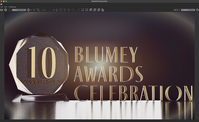

      When I view my scene in the RedShift Picture Viewer the scene looks correct.

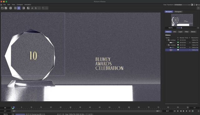

      When I import the C4D file into AE there is some strange scaling of the Illustrator import where the text seems scales.
      When I view my scene in the Render Picture Viewer it appears like it does in AE with the text scaled small.
      I am not sure what is going on here and if anyone has experienced this or know what I need to adjust I would appreciate it.
      Please see the attached images. (Bottom image is correct)
      Screenshot 2023-11-30 at 3.33.46 PM Medium.jpeg Screenshot 2023-11-30 at 3.34.10 PM Medium.jpeg
        Hi bottle-steak,
        Has any part in Cinema 4D scaling? If so, please go to:
        Main Menu> Tools> Axis Center> Reset Scale * (use the cogwheel)
        Check both options.
        (In previous versions, the Axis Center was in the Mesh Menu)
        If that guess (as I have no file here) isn't working, please share the Spline/AI file.
        • B
          bottle-steak last edited by
          Hi Dr. Sassi,
          sorry for the delay. You suggestion of Reset Scale seemed to do the trick.
          Thank you
