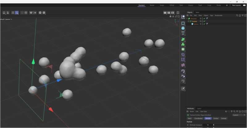

      In version 2023, I can drop an emitter onto a metaball generator, and it "metaballifies" the emitted objects.
      If I something similar in the new particle system in 2025, it doesn't work:. Here, I add the emitter and particle group as a child of metaball.

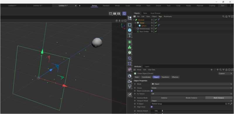

      and here I also add the cloner as a child of a metaball:

        Hi atomician,
        In 2025 the Standard Particle Emitter is now the "Emitter (Legacy)" - as you mentioned) and it works as before
        CV4_2025_drs_25_PAlg_01.c4d
        With the new Particle Emitter, the Emitter is not the "storage" of the resulting particles, it is the Group.
        CV4_2025_drs_25_PAlg_11.c4d
