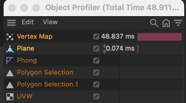

        You can check the specific processing time in the
        Main Menu> Window> Object Profiler.
