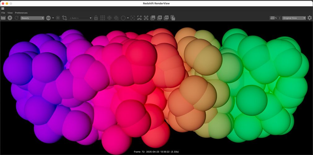

      But we can do this: Here is a project file; please run it from frame zero, stop when you have some particles, and then render. Does it look like this:
      CV4_2025_drs_25_RSpt_01.c4d
      login-to-view
      There was a while ago a problem rendering in progressive mode worked, but not in bucket mode. If Hair was used for rendering.

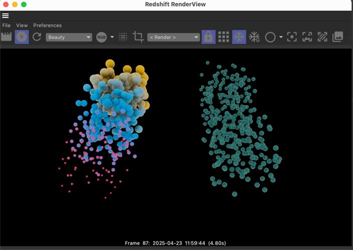

          I wanted first to test the particles alone.
          Please, as the next step, explore this file
          https://projectfiles.maxon.net/Cineversity_Forum_Support/2025_PROJECTS_DRS/20250423_CV4_2025_drs_25_PAch_01.zip

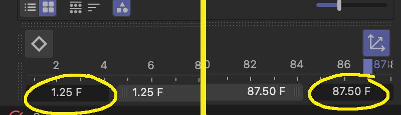

            I got it to work! The problem was a frame mismatch. The default C4D file on the new release(the 3D layout of the C4D logo) has a nice lighting and backdrop setup. Since I am a bit of a beginner with C4D I used that to make my new files, as the stage was already in place.
            The problem was that this document was frozen/paused on frame 1.25, so when I deleted the logo, then began working and adding keyframes, they would be set to .25 on each frame, so F1.25, F.2.25, etc.
            When I went to render, I set it for Frame 0 - 250 and I think it could not see the .25 frames so couldn't render them. Once I went into the scene and set everything to single frames with no decimal, it worked.

                It's the default startup scene. In the preferences under Files>Startup>Logo
                That scene is frozen at frame 1.25.

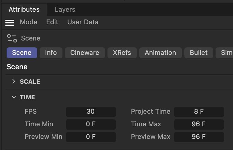

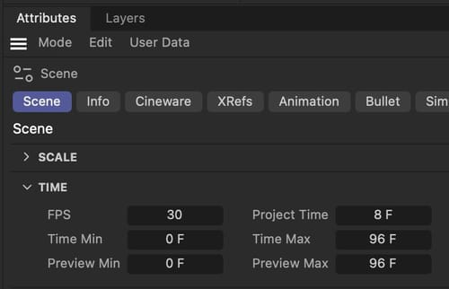

                  That is not frozen; you can change the start and end of the project accordingly. In the timeline, it is in the left and right corner for the start and end.
                  login-to-view
                  Or in the Attributes (manager) > Mode> Scene
                  login-to-view
                  When you have deleted the Logo Animation, all keyframes are gone, and nothing should be a problem anymore if you set the start to zero and the end to the project duration you like to have.
