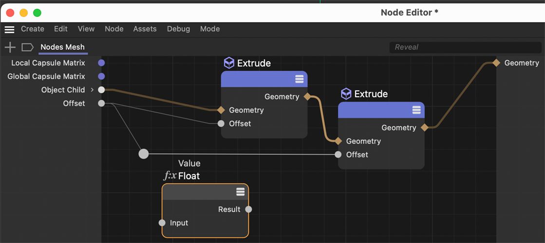

      More specifically I have two extrude line nodes, and I want to take the offset of one and use it to drive the other. I can't seem to find a way to get an output for values of a node, only inputs. Is there a way?
      Thanks!
        Hi cook-method,
        Why not take an input or a Value Node and connect both to this?
        • C
          cook-method last edited by
          Thanks for the reply, perfect solution, thanks!
            You're very welcome, cook-method.
