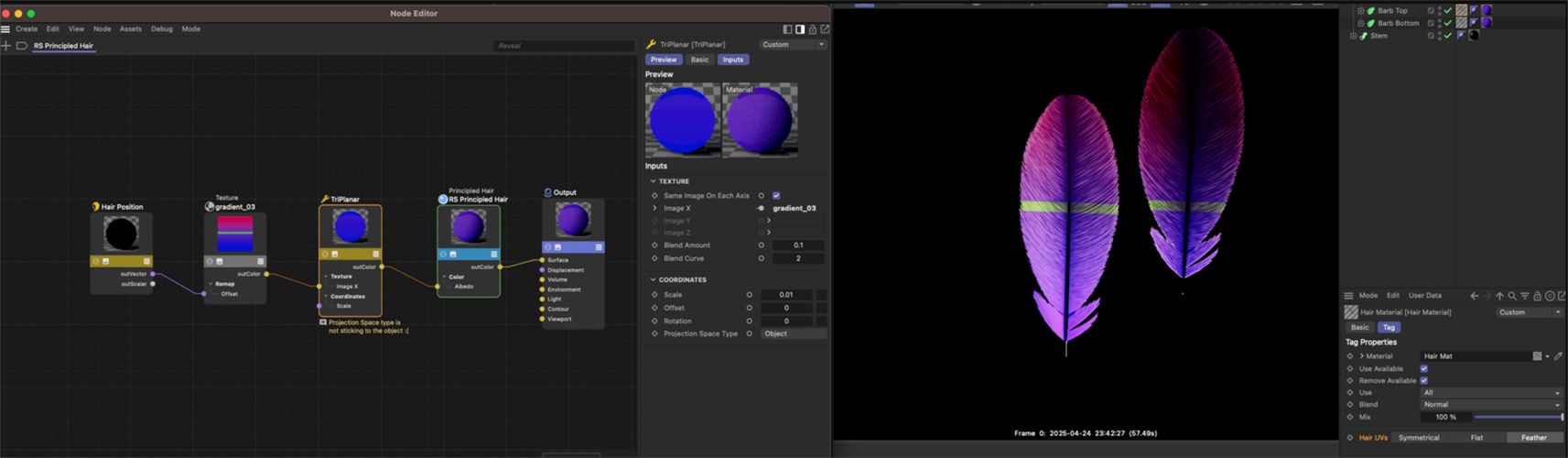

      Since this seems to be a known issue I am trying a workaround with a TriPlanar node to place the texture onto the feather.
      This was successful to get the texture onto the feather however when I move the feather objects position the texture does not stay on the object. I have the TriPlanar Projection space set to Object ( I have also tried reference ) still no luck getting the texture to move with the object.
      Questions:
      • I am assuming the UV Feather selection with RS is not fixed (support ticket Ticket ID##605775 created 2 years ago ). Does anyone have different information or findings on this?
      • Does anyone have any thoughts on why the TriPlanar texture will not stick to the feather object? Is there something in the Hair attributes node editor that could help?
      • Is there a better way of doing this that I am missing? I would like to keep the feather object procedural and avoid baking it but I am open to anything at this point.
      Thank you kindly

        As a side note, the TriPlanar is a good idea in a few cases; anything animated might not; it is, at best, a case-by-case decision.
