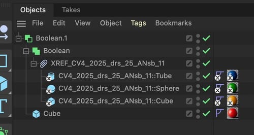

        Edit: back in California, here is an example
        CV4_2025_drs_25_ANsb_01.c4d
        OR load the file …_11.c4d as Xref into …_21.c4d
        CV4_2025_drs_25_ANsb_11.c4d
        CV4_2025_drs_25_ANsb_21.c4d
        /edit
