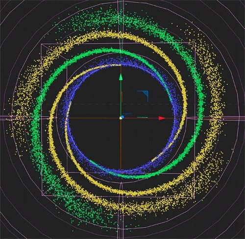

      Was wondering if you knew of a technique to create this swirl/vortex like effect please. I've done a few attempts but can't seem to get that shape on the tendrils where it starts of thin, puffs out and then thins out again. swirl.jpg

        The version …_21.c4d might be close, but have a look at previous versions; perhaps you can take some parts of those.
        CV4_2025_drs_SIsr_22.c4d
        CV4_2025_drs_SIsr_11.c4d
        CV4_2025_drs_SIsr_01.c4d
        Working with Follow Splines is tricky, as they jump to the next or (if the value is smaller) lose connection. Hence, my focus is on Forces with some Fields to add variety.
        Please let me know if anything is unclear or could be improved.
        Perhaps work with a few emitters to separate the "brightness" of the particles more easily. …_22.c4d

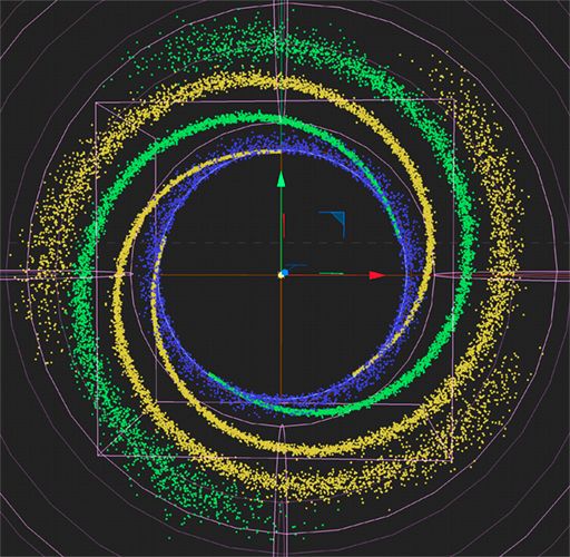

          P.S.: or is it more this, press play
          CV4_2025_drs_SIsr_31.c4d

            Hi Dr Sassi. Was having those issues using follow spline. Thanks for the tips, really helpful to see the workings. Had a play with 31.c4d by changing the size of the emitters mid animation that seems to create the crescent shape on the tendril.
            Say I wanted to have the particles small towards the beginning and end of the spline and big towards the middle. I've used a data mapper to give size variation to the particles using age. Is this the best way to do this with particles along a spline?
            cv4_2025_drs_sisr_32.c4d
              Hi Vii,
              Your image and text convey different ideas about the size, with the text being larger towards the middle, which means the curve you have set would be mirrored vertically. Do I get this right from your file? Either way, yes, I would use the Data Mapper.
