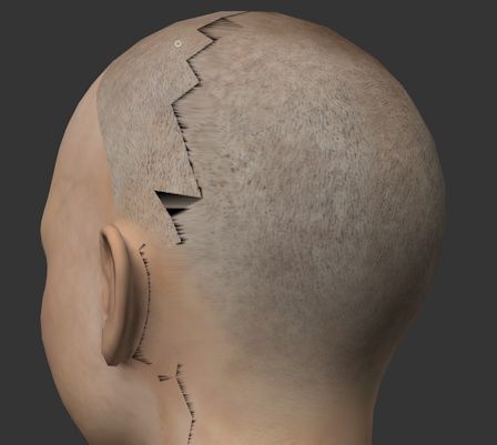

      I know Cinema4D-21 is no longer supported but I'm hoping someone will know if the issue is a limitation or some kind of setting issue.
      In Body Paint (R21) where an object is already UV mapped and has an exiting texture. When in 3D paint mode, such as simply using the brush tool, when I cross the texture seam it creates a clear overlapping looking line. In addition, when I use the smear tool it won't smear across the seam so I can't blend the texture to clean-up the seams. I also noticed the brushes round cursor gets clipped when crossing over the seam.

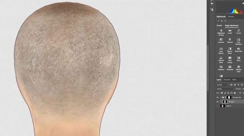

                      Attached are some screen captures. The first is what it looks like imported into Photoshop from Cinema4D 2025. See the black boarder?

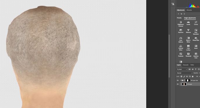

                      Second screen capture is after I aggressively increased the mask layer in Photoshop.

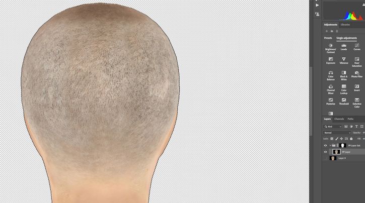

                      Third screen capture shows even after doing all this black line is still there and I also noticed the texture around polygons edges are distorted (zoom in on the hair stubble on the edges).
