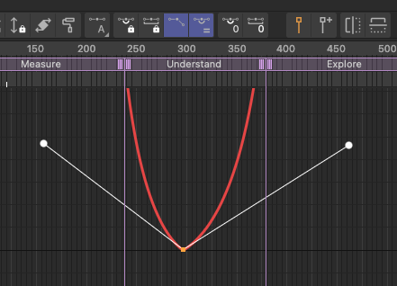

      I select this keyframe and copy the easing:

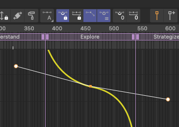

      This is it after pasting the ease:

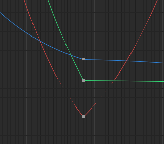

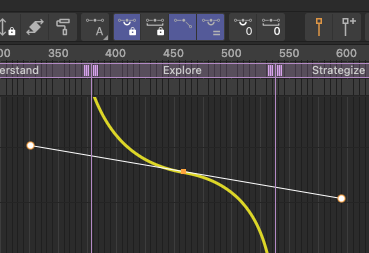

      They all break differently but they all break:
