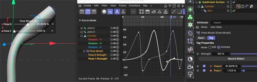

              P.S.: Here is the PoseMorph version, if set up properly, and the sliders as HUD on the screen, the Art-Direction is fast and provides a more "organic animation" than an algorithm in my book.
              Demo file
              CV4_2025_drs_25_ANsm_11.c4d
