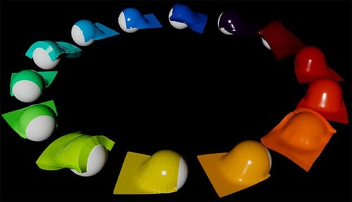

        Hi Harry,
        Please have a look here.
        CV4_2025_drs_25_RSuc_01.c4d
        Also, please open a ticket to get access. I can't make exceptions here. Thank you for understanding.
        Enjoy your weekend

              The simple answer is that generators, like the SDD, generate new Geometry, and that doesn't include any MoGraph ID.
              An alternative could be: (color or ID, both works.)
              CV4_2025_drs_25_RSci_01.c4d
