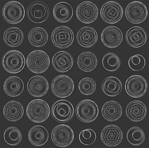

                Hi williambillcard,
                Thanks for the file.
                Here is a simple set up, adjust the clone amount as needed.
                CV4_2025_drs_25_MGsp_01.c4d
                The four groups under the Sub-Cloner are copies with different parameters.
                The Sub-Cloner is set to "Blend", and the Plain Effect is set to "Modify Clone".
                The Random Field in the Sub-Cloner changes the outcome based on its Noise-value for each Clone Produced then with the Main Cloner.
                All animations are set in the F-Curve to Offset-Repeat.
                Enjoy your project
