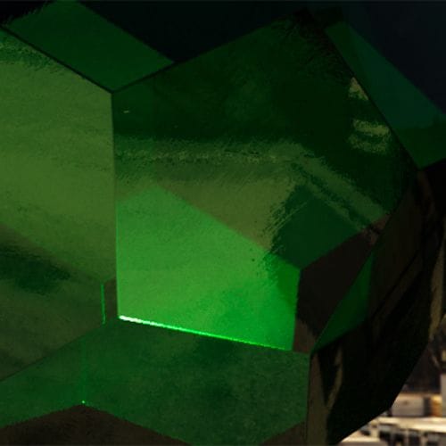

      Where is the correct place to put a surface imperfection image in the standard/physical render materials? I have a transparent material that I want to have some surface imperfections on, such as the si-v1_smudges_05_15cm_1k from the assets browser. I've tried putting in various places in my material but nothing ever shows up.

        Hi David,
        There are a few options; it depends on the amount of render time you're willing to invest.
        A fast way is via Normal Maps.
        Example:
        CV4_2025_drs_25_SRar_01.c4d
        Please note that I have also adjusted the UV data.
        The Bevel Deformer is used to correct the contraction that can be seen due to surface artifacts, especially when super-precise edges are involved.
        Switch it off, you like to have it differently.

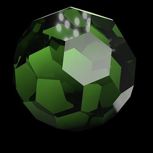

          Hi Dr Sassi,
          Thanks very much this, I had a go at it on one of the actual models that I have to work with. I found that the geometry makes a big difference as to how well it worked. Some of the models aren't made by me, some are sent by the manufacturer which are converted from CAD files so they don't always work that great, unfortunately I don't have time to re-model them 🙁

            Hi David,
            Sorry to hear that you're not getting the results you are after.
            Please note that CAD models often need work (at least they did so in the past three+ decades for me)
            I assume you can't share one. (If possible, please use only Wetransfer, Google Drive, Dropbox, Adobe Cloud, or Apple Cloud services.) Please upload the content to the cloud as is, without compression (e.g., zip or rar). Please paste the full URL here, without a web wrapper. Thank you, and I apologize for the lengthy security-based request.
            I'm unaware of your background, but I also write in a forum, so I leave this here for anyone following along:
            Often, CAD models are great at the source, but export settings are applied that don't make them easy (if at all) to work with. For the creator of such files, it is often just a few checkboxes to change, and typically, they strive to produce good results if they know what is needed and wanted. In other words, let them know what is needed or what isn't working.
