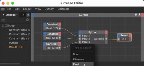

So among other inputs, I want 3 inputs of type "Real" to input mixed values to my script. This is where it gets weird:
- When I create a new Python node, it comes with two inputs, and both of these are "Real" inputs. Right click on them > port inspector > says they're "Real".
- However, when I click on the blue corner to create a new input, there is no "Real" type in the list??
so it comes with two as standard, but you can't duplicate them, copy them or create them. (But you can delete them). I need 3 real inputs... how do I fix this?
Steps to reproduce: create a null, add an Xpresso tag, open it in the Xpresso editor and add a Python node. Check the default inputs - both "Real". Then try and create a new input - be interested to know if it's standard for everyone not to have a Real input option. I'm running C4d Version 2025.3.3
Hi atomician,
Yes, that is not clearly set up. Use the Float entry to create a new Real input.

Thanks Dr. Sassi. The real inputs are just super useful for connecting any data type, whereas the float is fixed to be a float only - you can't link anything into it. I don't use the dev forum a lot - will have a look though.
Is this a bug do you think? wasn't sure whether to report it to maxon but not sure if theres any reason that real inputs aren't included?
Hi atomician,
Float here is any single number (vs. Vector or Matrix). You can "pipe" in, even Boolean values. Think of it as a family name used in Cinema 4D for numbers. Internally, it is changed to a "real" float.
The User Data interface might provide a good hint at how it is used. Float the group name, units for the evaluation what the input is.
The term Float is used (for example) for image formats, like the industry standard OpenEXR, whereby the numbers used here are exponential numbers, but also with such formats, no image or compositing app to my knowledge requires placing exponential formatting into the parameter fields to even change a single pixel.
The input in Cinema 4D is anything when set to float, single parameter for Real, or three for Vector, or 12 for Matrix. Each time it accepts Real, integer, or even other number-based data (Again, Boolean, 0 or 1 for false or true). So, I can't even see remotely a limitation here.

Thanks Dr. Sassi, that makes loads more sense now. I was thinking of it like a float in javascript, where it can literally only allow a floating point number. I can see now that float inputs can accept all different inputs - thanks for the clarification!
