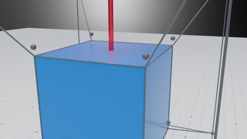

Hi there.
I have 8 spheres parented to 8 nulls. When I move the nulls, sometimes the position of the spheres doesn't update in the Redshift Render view unless I reset the render; that'd be fine, I could live with it, but when I to the actual render, the spheres are offset as though they're getting old position information from a frame ago. I have no idea why this is happening! Here's a render to illustrate the issue (hopefully it helps); I'd appreciate any help! Thank you!!
Hi Balakay612,
When you see that and press the "a" key, are the spheres in place? Or if you cache a simulation first.
If so, it is presumably a Priority problem.Please always share the file reduced to the problem. An image tells me very little, especially when cropped and nothing else is shared.

Thank you for your response! It seems to have been an organizational issue: once I rearranged the offending elements (placing the grouped Nulls at the top), my test renders were corrected.
And you're right about a photo not being terribly helpful: I'll provide scene files for future issues. Thanks again!
