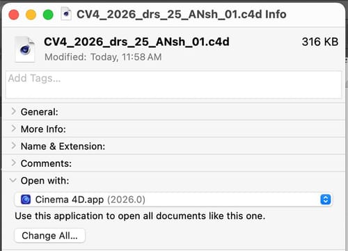

        Hi entry-newspaper,
        On a Mac, use the CMD + I to get the information about the file you like to open, then set the application you like to use, and if that is needed for all, use the change all button.
        If that is only wanted for a single file, use the Right-Mouse-Click to get the Open With option. If 2026 is not in teh list so far, scroll down and use "Other…". It should be in that list after this first time.
