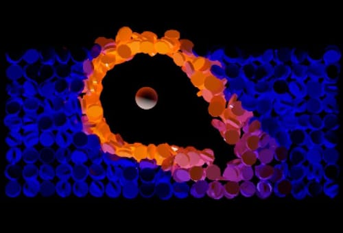

I've got a super simple dynamics scene where a sphere goes though a bunch of clones and pushes them appart, I now just need the material of the clones it comes in contact with (full clone not partial) to change color.
This is pretty mush the kind of thing Im trying to achieve: https://www.instagram.com/p/DFfihSotYd-/?hl=en
I tried feeding some fields through to a VERTEX COLOR TAG - a FREEZE to make it 'grow' across the full clone when in contact, but I then to fade away I thought a DECAY on top would work. But on top of the FREEZE it does nothing.

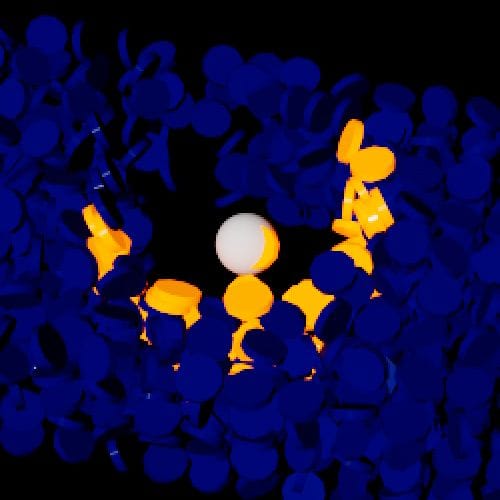

I've run with that but it looks kind of abrupt in the render, so i really want to add a little decay or delay.
i've managed to get it really close here: https://we.tl/t-SRPR92ZXX6
rather than fading off from the shapes falloff which looks really obvious, I really like the decay how different clones fade back to black at slightly different times in this one.
But toward the end of the animation it stops turning them white, Im guessing because those ones already turned white earlier they cant be turned white again. It seems like it should be so simple to grow on and grow off when contacted with a slight decay but i cant get the blending right.

CV4_2026_drs_25_MGsc_11.c4dThe main setup to drive the Material is in the Plain Effector.
Since your request was to have the Material for a clone and not a partial clone, this works on the whole clone.Enjoy the rest of your weekend!

The color via Effectors (including Fields if used) provides a single individual value for a clone, hence it affects the clone completely.
I forgot to mention, check the color in the Cloner> Transform. When it comes to color, the color in that section can cause unwanted (or wanted) results. Black is typically a good starting point.
