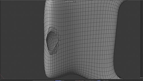

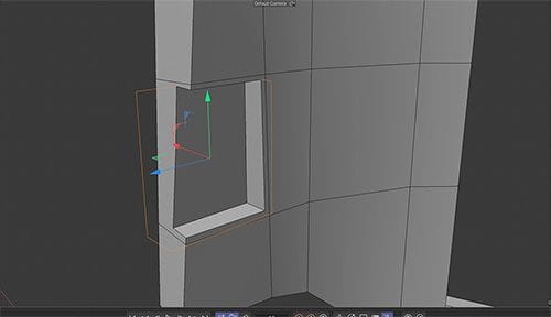

      Basic geometry question. I am try to boole out a shape, but when I add a suddivision it creates a hole.
      When I add lines to help with the geometry I keep getting the hole, not the part I want cut out.
      Any ideas what I'm doing wrong guys?

          Hi earth-video
          Please share the file. The geometry will be below 1MB. I can then share a file back that works and share some thoughts.
          From the images, I can only guess, which is not a good idea, as I have to make assumptions.
          Like: do you Boole a cube from another and then add an SDS, while leaving it on N-Gons? N-Gons and SDS rarely work well together.
          Image-based: Why not "Slide" the neighbor-edge to get close to the intended Cut-out, add a loop in the middle of the small side to get that edge as well, then delete the polygons where the Cut-out should be, and create a few new polygons, then add supporting edges. Check that no N-Gons are left and explore the SDS again.
          (Attribute Manager> Mode> Modeling> Mesh Check)

              The supporting edge is an old and good technique, but sometimes, the SDS Weight is faster and easier to use:
              https://help.maxon.net/c4d/2026/en-us/Default.htm#html/OSDS.html#weight
              perhaps also here
              https://help.maxon.net/c4d/2026/en-us/Default.htm#html/TSDS.html
              To build the Arm of the Glasses, I took just the outside of the frame (Split) and welded a lot of points first. With that, I extruded it and added the details. To keep the polygon count of the main object low is always my target. Like in Illustrator, the more points are given for a specific area, the less power each point has. However, at the same time, it becomes increasingly difficult to manage.
              The functions, options, or tools I use are as follows: Extrude, Inset (extrude Inner), Weld, Slide, Dissolve, and the Knife tool. Those are essentials for me.
