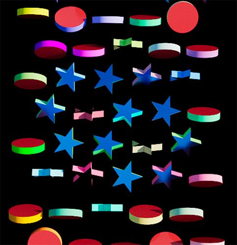

      Thanks for that, that method works well, but if I make the effect happen from the center instead (attached cv4_2026_drs_25_mgta_11 v2.c4d), it doesnt work properly any more - the speed is all messed up.
      Also I tried making the fields scale of your first file linear, but they still seem to move at different speeds (cv4_2026_drs_25_mgta_11 v2.c4d)
      I've been struggling with this one all week, I watched all those Cineversity videos you suggested and tried a new setup (test 1 and 2 attached) but sometimes it works and sometimes it doesnt
      Test 1 - the animation alone works great, but when i put it into a cloner it freaks out - seems to be something to do with the delay
      Test 2 - is an almost identical setup, but works well, however if I replace the objects with the ones I want to use for production, it freaks out again like Test 1.
      I really dont get it.
      Seems like it would be such a simple thing to do in C4D with Mograph - It used to be easy to do this kind of thing with just falloff before fields were introduced.
      Any ideas? I'm about ready to give up on it.
      Files: https://we.tl/t-DykuPMNtDQ
      Thanks again

          Sorry about that, here's a video showing what I mean https://we.tl/t-tNtohUs64h. See how the baked animation is fine, but when I put it into a cloner and try to offset it with fields it just goes crazy, I just dont understand why as I follwed the cineversity tute to achieve the effect. All I want to do is offset that baked animation so it plays via a field

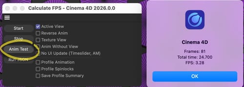

                I miss the results from the Object Profiler or if that is not an option to answer, please try: Shift+C--> Calculate FPS -> Animation Test.
                Let me know what FPS it shows. Here is my results with 361 clones:
                Frames: 81|Total time: 24.700|FPS: 3.28 (I tested a few times, that was the best)

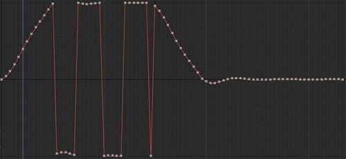

                    I have to ask, since I'm not clear if this is intentional or perhaps the reason for the problem. I took the F-Curve so far as a given. But perhaps here is the problem. Here is a screen shot of your animation.
                    Are these 360º jumps intentionally, or just a Quaternion vs Euler problem
                    https://help.maxon.net/c4d/2026/en-us/Default.htm#html/OCYLINDER-ID_BASEOBJECT_GROUP1.html#ID_BASEOBJECT_QUATERNION_ROTATION_INTERPOLATION
                    • MaverickMongoose
                      MaverickMongoose last edited by
                      Yes you're right! Moving those broken keys seems to fix the problem. The bake must have messed up the keyframes - I just used a track modifier for the bounce originaly. Weird that it looks fine without the cloner.

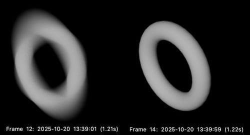

                        Thanks for the feedback, MaverickMongoose.
                        Yes it might look that way, but take that animation without the Cloner, switch on Motion Blur, and compare the results of frame 12 and 14. Use the Redshift Render, not the IPR.
