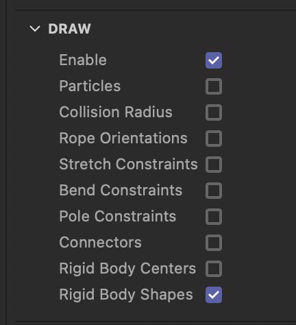

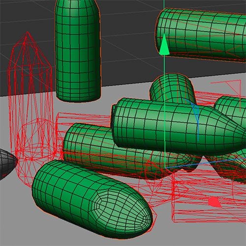

          Thanks for the file. Please take a look to see what happens first. Go to Attribute Manager> Mode> Scene> Simulation> Simulation>
          Draw> Enable and Rigid Body Shapes.
          Doesn't look good? Correct.
          To fix this, go to the Cloner> Transform> Rotation to zero degrees.
          Now run the sim again. Should work now.

            I see, it's weird that it wouldnt take the transform into account from the Cloner, I guess it just doesnt adapt to that when being generated from a particle. I need objects to apear while being oriented upward so I guess i'll just change the object axis. All good, thanks for that - good tip on triangle mesh too!
