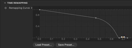

        Now, create with the Retiming feature, where each cube has a reverse effect. This can be done for all at once in the same way (if all are selected) or for each cube individually.
        Since they were lifted, they miss the bounce of a landing, that is the little curve on the right end. The long straight one is not physically plausible, but that is the part mostly out of the frame, I assume. After all we talk about visual expression here, correct?
