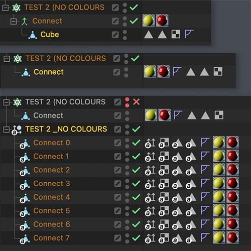

            Hi Cit,
            Staying inside Cinema 4D makes it easier. Thanks for the addition information.
            In your video, the setup that will be the base of the Alembic had no material at all to begin with. 00:03 [min:sec]
            However, I get your point.
            So, create a copy of your setup, with materials applied, then select the Connect object and press the C key for a moment to make it editable.
            Now select the Cloner and use the Alembic options to Bake.
            Image below the three steps.
            Alternative, select the Connect object, use the Current State To Object, and swap the result (a Polygon Obj. named Connect) with the original Connect Object, now bake to Alembic.
            Please let me know if that works.
