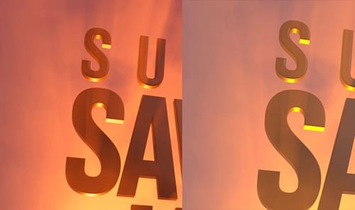

      Hey guys. I'm saving stills from Cinema 4D Redshift 2026. I love the colors in the Picture Viewer, but when I save them (TGA or PNG) they are less saturated or a little hazy. I've attached a side-by-side comparison. The image on left is a screenshot from the Picture Viewer Thx for the help!
        Hi battle-kid,
        Can you share more than an image? Perhaps the Project file.
        There are various color settings, and I have no idea what your setup is, in Cinema4D or in the app you used to compare.
        What image setting is on the left, what colorspace, etc?
        Where is the comparison done, in Cinema 4D or in Photoshop?
        Are the right colorspaces applied? From the image shared, the first idea was a wrong gamma, but the saturation doesn't add up when gamma is explored alone.
        I hesitate to just answer from memory, and give just a "Tonemapping", etc., answer, as that doesn't help you. I need to explore it, as I can't reproduce this here.

            WeTransfer Link. I'm bringing the still into photoshop after rendering the still.
              Thank you very much, battle kid. The file is a great help!
              I have rendered the scene, then saved it from the Picture Viewer as a PSD and a TGA. Open both in Photoshop, and I can't see a difference. I even switched the Color engine in PS back to sRGB to see if that helps (I typically stay in larger color spaces. However: No difference.
              Getting closer (but not matching your results) if the Image is assigned (Not converted to!) a Color Profile of my Monitor "DCP-P3" instead of the small sRGB. In that moment, the comparison comes very close to your comparison. Since that has no indicators and is only close to your observation, I exclude this here.
              What I can tell, if you got the PSD from the Multipass (which should be in float to work properly for all), you get a Linear encoded pixel value in the file. But that is not how the file will be read. When compared then with 8bit/channel float, while ACES was used, a list of changes are created, to avoid clipping of dynamic and gamut, which changes values. (Working against those changes, is not advised, as in 3D we work with scenes, not just images. Which is a longer story, and not the concern here.)

              In comparison, I get what you experience.
