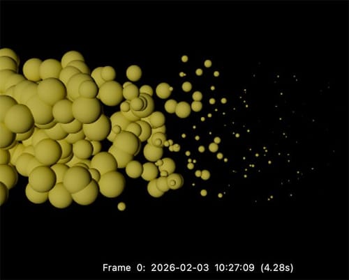

                  Here is a setup.
                  The last frames of a particle getting smaller seem simple, but then we might forget the Variance of the lifetime. To get this handled, the Lifetime and the Age (both provided in Seconds, to allow frame rate adjustments later on) need to be evaluated. Then, if the remaining lifetime is below a certain threshold, the progressive radius change starts. The amount of change for the last segment is in the If Condition. The example has, for a better exploration, a "shrink-cycle" of 2 seconds (See Condition) and a scale down per frame of 0.9 (If Node), adjust accordingly to your needs.
                  CV4_2026_drs_26_PAst_01.c4d

                        The simplest way is just a Data mapper, lifetime to Radius. But that is not along your requests, as it sets the fade in, fade out to various lenght, if the life time varies. An exact frame number for all individual particles is not given. If that is not a problem, here is the simplest way.
                        I left an alternative in it, with a ramp.
                        CV4_2026_drs_26_PAdm_01.c4d
                        The beginning is simpler, as all particles start with the first frame; they are "born" and age from there.
                        To keep it simple, that can be done with a Condition.
                        Example:
                        CV4_2026_drs_26_PAst_03.c4d
                        When the growth period is over, it gets moved to the next one, which is the same as the one above, discussed with the problem of variance regarding lifetime.
                        Is this working for you?
