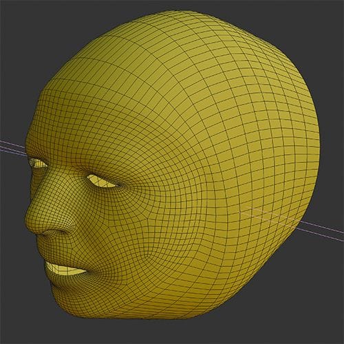

      Hi, I am trying to apply cloth to a procedural mesh. The mesh merges a face mesh from "Moves by Maxon" with a Loft. In order to let the loft's edge points have the same position as the face's edge points for a exact weld, I used a edge cloner or the "edge to spline" plugin. The points are welding correctly (a subdivision object or smoothing creates a smooth even mesh).
      When applying a cloth tag, the mesh shows constant glitches. It seems like the mesh topology would constantly change. Maybe the procedural edge points causing a problem, although if it's point ID's would change, the loft and and welding would change too (not only the cloth simulation). I tried many approaches (using morph, scene nodes, etc.) Nothing works. Thanks for any suggestions!

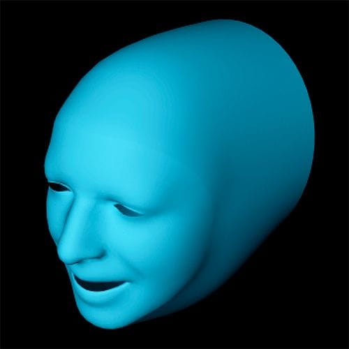

                Thank you for your suggestion. I am looking for a none destructive, procedural solution as the face and the loft will change in future. In the original scene, the actual Moves by Maxon face mesh is used and will be replaced with further face captures. I just baked it to simply the scene. Also, the design of the loft extrusion needs to remain procedural during the creative process to test the behavior of different loft shapes along with the cloth simulating. Thus, the procedural welding is crucial.
                I have tested the welding intensively by adding a Smooth Deformer and Subdivision Surface to the procedurally welded mesh. If points would not be welded or wrongly welded, it would cause already visible glitches, holes or or hard edges. So it seems the problem is somewhere else...

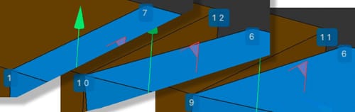

                  The point numbers change constantly, and since the points are exactly on top of each other, which one is used is “survives the weld is random. The only way to make the points stable is to move the part that should have a stable polygon number a little bit, in this case, to negative Z, while also being the lower child of the Connect. However, that requires increasing the weld tolerance. Which in return has a lot of new weldong of points, and the change here is not wanted, of course.
                  A simple example of the changing Point ID numbers:

                      In the moment a single weld “pair” is no longer a single point, the ID of each following point will change, since we have two objects in this mix here, the IDs are sorted one after the other.
                      In the 10-second clip I made for you, this is demonstrated, first the move, then which object is closer to the Connect object in the Object Manager.

                      I am typically careful with calling something a bug. Not to be biased here. But settling for a bug means stopping to understand what happens, hence the video.
                      As I mentioned above, there is a lot going on, and PLA and Cloth are both point-related. If anything is placed to them before the Connect is working, that is not a problem, but if the Cloth calculates points, and the ID is changing, then there is confusion about what is going on. Since animation changes over time, the change needs stability, meaning stable IDs over time. Motion Blur, for example, later on in the mix, and essential for any professional production, can’t know when an ID vanishes and then frames later pop in. Just one pair of points welded or not defines a lot of other point IDs to change.
                      There are just limits, and not everything that can be combined and results in stable situations.
