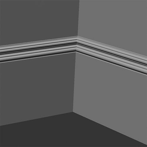

      Apologies if I've asked this before, I likely forgot.
      When sweeping a profile around a spline, say for a baseboard, often the result is inverted. Is there a better way to fix this instead of messing around with the axis of the profile itself?
      https://www.icloud.com/iclouddrive/0d4Ka575i7ZVmmJtExYcKPjuQ#Baseboard
        Hi smckenzie,
        Thanks for the file.
        Select the Thicken. Spline and use the Main Menu> Spline> Point Order> Reverse Sequence if it is 180º
        In difficult cases, you need to work with a Rail, typically switch "Use Rail Scale" off.
        Let me know if that helped with your project.

            Hi smckenzie,
            Here is what I see when I do it
            or as screen capture
            https://projectfiles.maxon.net/Cineversity_Forum_Support/2026_Clips_DRS/20260129_Baseboard.mp4
            And here is the file
            CV4_2026_drs_26_MOsr_01.c4d
            Let me know what is different when you do it.
