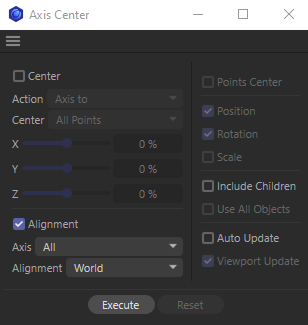

        Select all the objects you ant to reset the Axis and open the "Axis Center" Tool from the "Tools" Menu.
        Deactivate "Center" and activate "Alignment".
        Set Axis to "All" and "Alignment" to "World"

          Excellent, exactly what I was looking for! Thanx Athanasios!
