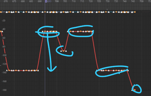

Hi there,
There must be a way, surely.
Let's say I want to align all the highlighted frames (in the blue circles) to the level of the others (moving them down). I can do it manualy, but there is no accuracy, so my values are displaying unwanted value with decimals.. How can I do it with accuracy?
Thanks,
Arnaud -

I don't know hot to do that by dragging, but you can adjust multiple selected keyframes by typing e.g. x+100 in the field in the attribute manager.
Excellent, thank you, that's already a solution!
