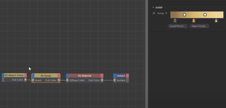

      I am following along with this tutorial: https://youtu.be/zYIzpC5N8ng
      He uses the Shader Graph to create a material that has a noise with 3 color values by connecting the Maxon Noise node to a Ramp node.
      I am trying to recreate this material using the Node Editor but don't know how to do it. I tried connecting the Maxon Noise node to a Ramp, but there is no generic "Input" node in the Node Editor, like there is in the Shader Graph. I tried connecting the Maxon Noise's Out Color to every possible input on the Ramp node, but none work and they all give an error that says "This port needs a consistent value".
      How can I create a noise that has more than 2 color values within the Node Editor?
      Desert.c4d
        Hi miss-bear,
        Thank you very much for the file!
        Here is your file back.
        CV4_2023_drs_23_RScr_11_desert.c4d
        The black to white values of the noise will be "mapped" to the gradient or ramp if you like. So the ramp colors will vary. I assume you know that, but I write in a forum. Thanks for understanding.
        Just as a general idea, the setup with both node systems:
        CV4_2023_drs_23_RScr_01.c4d

            kariomart last edited by kariomart
            Thanks so much Dr. Sassi! "Alt Input" was what I needed for the Ramp node. I'll definitely be tuning in to EJ's presentation.
            I'm trying to better learn Redshift, but the majority of tutorials seem to be using the Shader Graph and I keep running into similar issues like this. In your opinion, is it better try and figure out the equivalent way of doing them with the Node Editor, since it seems to be the future of Redshift, or is the Shader Graph still worth learning?

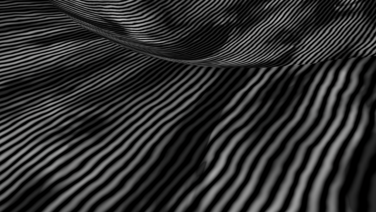

                One more related question! I am trying to created the wavy lines on the sand and have this setup I want to use for my Bump Map. Here is my Color Layer node soloed and what I want to use for my bump map:
                But when I connect this to the Bump Map channel, this is the result I get. I have the Height Scale of the bump turned up pretty high, otherwise I hardly see anything.
                The result is very contrast-y and doesn't look like my soloed Color Layer. How can I achieve a result closer to it?
                  Thanks for the file, miss-bear.
                  Bump is a fake, kind of. It has limitations. The change of input values provides some ideas about a simulated surface orientation. It is excellent for tiny details. Sand-corns itself. To create these ripples in the foreground, I wouldn't suggest it.
                  In your scene, the light is more tangential than from the side or top, which puts the Bump idea for ripples under huge stress. Since it doesn't change any geometry, the details do not cast any shadow. What Bump does well is brighten or lower the values on the surface to simulate details.
                  With that in mind, I have set up a few things differently. The ripples are Displacement based, and the details are Bump based. (Normal mapping is a better version of bump, it is more precise, but for Sand, in this case, I assume Bump is good enough. Bump works with one channel, Normal with three, so I go with the lower amount of information if possible.
                  https://stcineversityprod02.blob.core.windows.net/$web/Cineversity_Forum_Support/2023_PROJECTS_DRS/20230408_CV4_2023_drs_23_RSns_01.c4d.zip
                  You need to adjust the Bump Noise for the render size you like to have.
