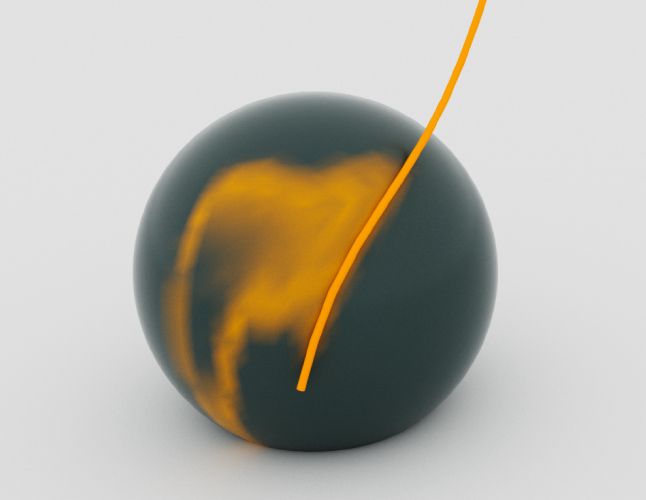

        Hi swim-package,
        Please have a look here:
        CV4_2023_drs_23_SIpo_01.c4d
        Is this what you like to have?

          This is exactly what I was looking for - thanks so much!

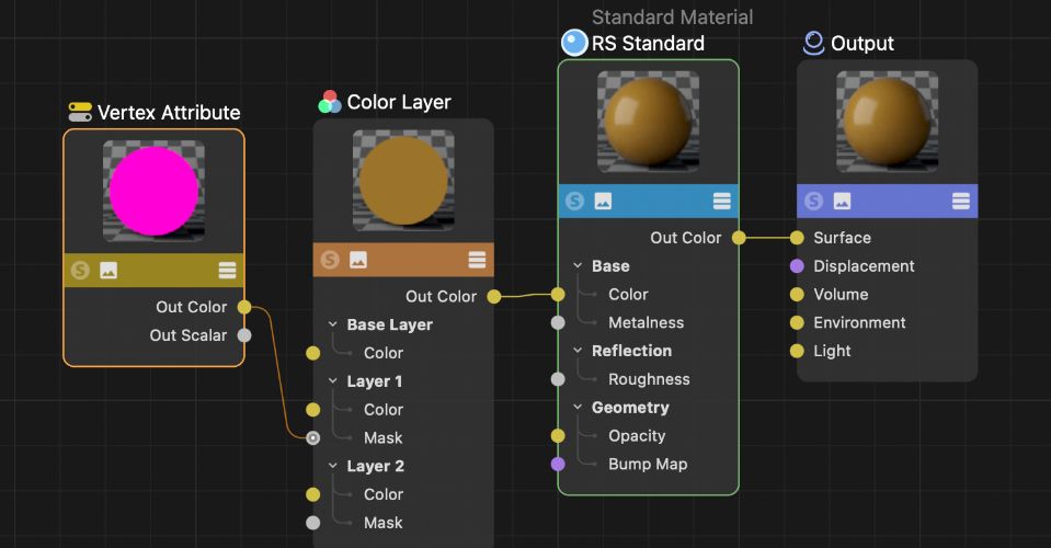

          So how would this work if I wanted to drive my diffuse colour within Redshift. Would I use Color User Data to achieve this?
            Hi swim-package,
            This is exactly how it is set up. See image.
            It is based on the Vertex Map Tag. This Tag, while named wisely, is inside of the Vertex Attribute.
            The Freeze layer stores the data.
            If you need additional colors from Splines that hit later, use another Vertex map Tag, drive the next mask with it, and adjust the color of that layer.
