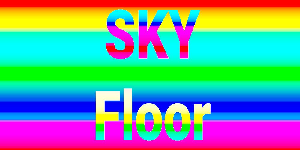

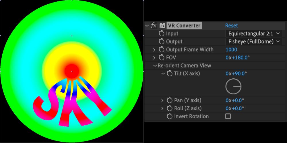

          May i add a few more questions here: For a dome projection, an equirectangular image would contain the info for BOTH the top AND bottom hemisphere. I assume that the bottom hemisphere is automatically discarded when converting to Polar image with AE VR tools. Is this correct or a different setup must be applied?
            Hi music-dust,
            The equirectangular is a 360º x 180º view. I would avoid fiddling with the Polar Effect in the case of a 360º x 90º target from an full equirectangular Image/footage. Even that was my way in the late '90s to create my first little planets in Ps. I mention that, as that is roughly the process, Equirectangular to Little planets.
            However, if you are in Ae for that, use the "VR Convert" and set the values as shown in the image.
            The Polar Effect works very similarly and has, AFAIK, the less accurate "engine" to do that.
            Since I do not know the projection lens nor the shape of the dome, I encourage you to use a checkerboard texture and convert it, then project it so you know if the local setup is OK.
            When you do that, perhaps check if you can use the RS Fish Eye Lens, to avoid rendering more than needed, while also avoiding the conversion step at all.
