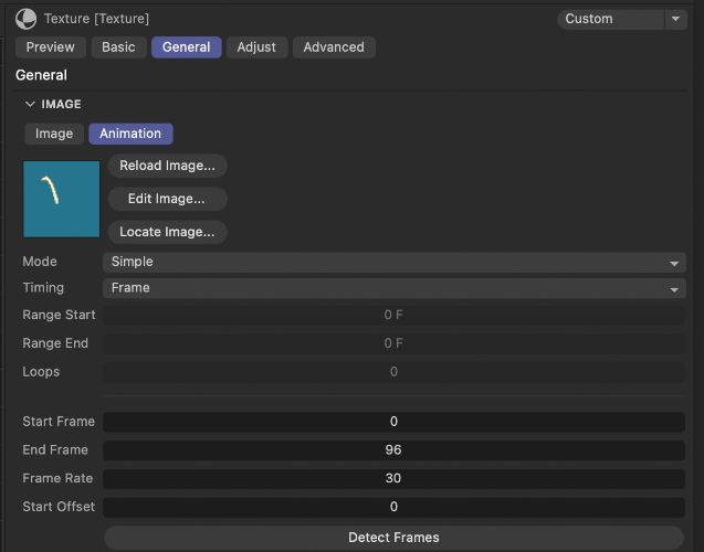

            In the Texture node, go to General> Animation and click the Detect Frames button. It will show a result if a sequence is recognized.

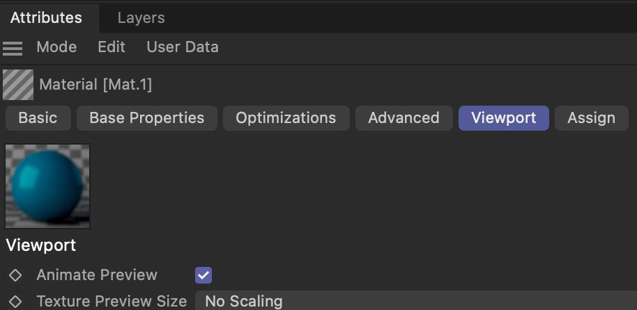

            Then go to Material (selected)> Attribute manager> Viewport> Animate Preview (checked)
            That should do the trick.
