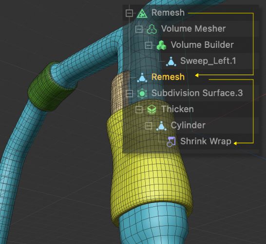

                  Thanks for the reply, AlexC.,
                  Yes, Shrink Wrap was the idea, not "Project".
                  The layering of these elements requires that a single object is referenced; perhaps an option is to create all first layers to the objects, then create via Volume Builder/Mesher and Remesh a new single object for the Shrinkwrap for the overall second layer.
                  I have no idea how to do this faster. Perhaps try to explore the Connect object (weld off) as a master parent for all existing parts. However, getting "dummies" from the Volume/Remesh workflow is more stable. Add the layers to each (here only the Sweep_Left.1" is shown, but to combine all, for the next step, it needs to be one object.
                  (Pale blue = "temp-dummy")
